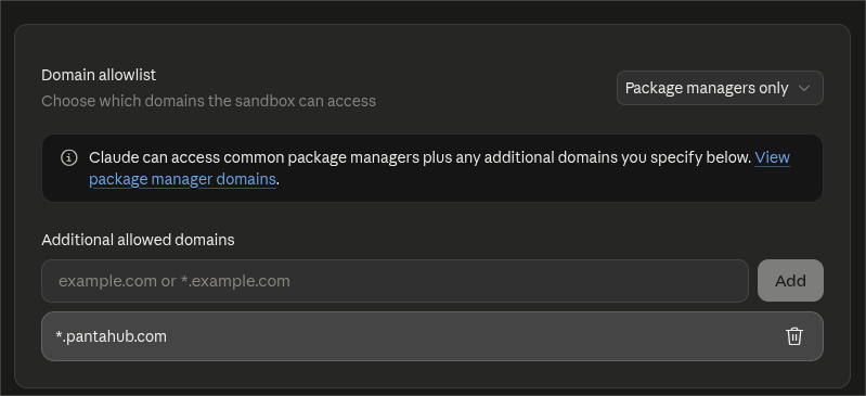

  4. To let Claude upload pvr exports to Hub, go to Settings > Capabilities and under the code execution Domain allowlist add *.pantahub.com to Additional allowed domains:
