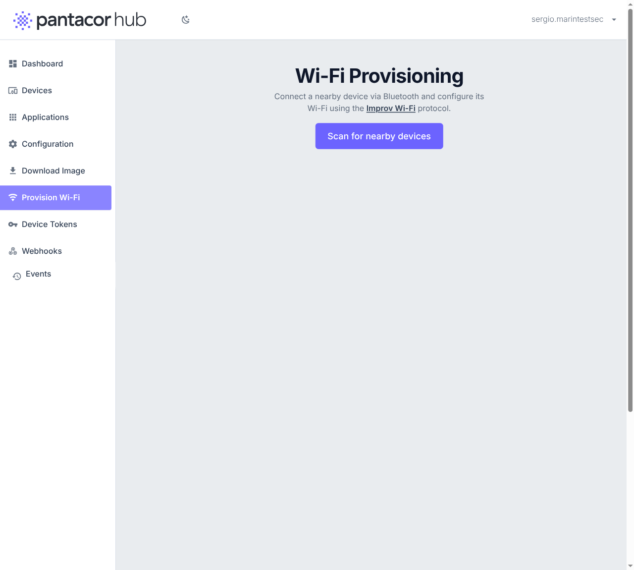

From the browser: Provision Wi-Fi in the Hub
The Hub has a Provision Wi-Fi page that talks Improv BLE directly from your browser via Web Bluetooth — nothing to install. Scan for nearby devices, pair, and the device reports the networks it can see (with signal strength), so you pick the SSID from a live list rather than typing it blind. Enter the password and the device is provisioned.
Once the device reaches the Hub, the flow hands you off to claiming with the device ID and challenge prefilled — provision and claim in one sitting. Web Bluetooth works out of the box in Chrome, Edge and Opera on desktop and Android (the page itself carries per-browser instructions for the rest; iOS does not support Web Bluetooth in any browser).
